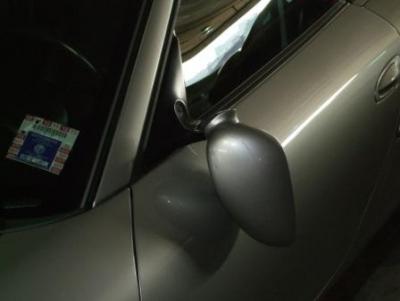

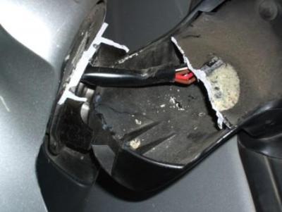

So I walked out to my car this morning in my parking garage and I found my drivers side mirror hanging there by the cord only. It appears someone snapped the whole mirror right off the car, the metal connector snapped in half. Attached below are some pics of the actual damage and I was wondering what parts I will need to replace in order to re attach the mirror. I searched the forum and I see there are like 13 different parts to the outside mirror and I hope that I don't have to replace the entire thing but maybe just the part that holds the mirror housing onto the door. Any help you guys can give would be appreciated.
You are going to have to look and see which parts are actually broken.
Looking at the chart it is hard to figure out. The only part that is physically broken is that metal part in my pictures, all else is good but if I had to pick the parts I would say part #4 and possibly the #14/17 line. Unless that the movable joint to fold the mirror in is part of the full housing (#2) I don't think I would need that. The internals (mirror, motor, bottom of the housing (#10), and the actual painted housing) are all in fine shape.

Loren, Thank you! I disassembled my mirror last night and it does appear that I need to replace part #5 on the diagram only. the part number listed in my mirror was 996-731-219-04 and that is listed on the sheet you attached. There are a lot of other #5 part numbers listed, do I need to order all of them or just the one. The car is a 2004 BoxS without the auto dimming mirrors.
