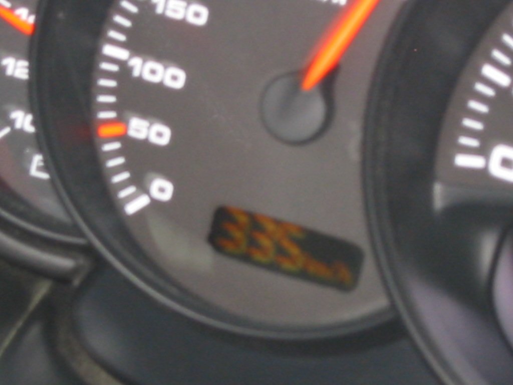

[...] I suppose you were just going to the shops to get some milk? :lol:
Yeah, you know how it is with these fast cars... You don't pay attention for a few seconds and suddenly you're slightly above the speed limit. :D
Sorry to slide off-topic, but you might like this one too:
(no, the car wasn't stock anymore...)

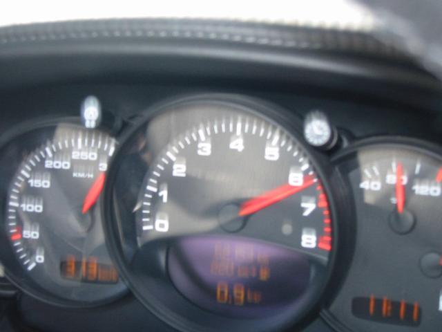

Wow! I am amazed. Pleasure of living in an European country...
