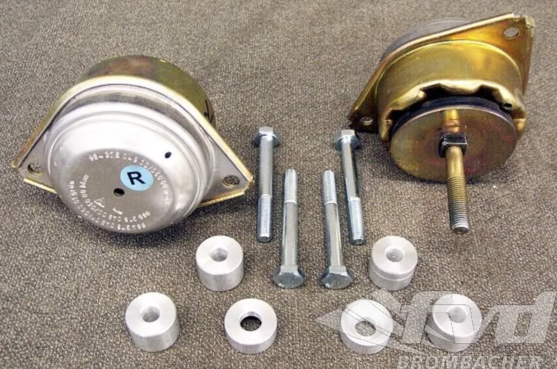

FWIW, here is a picture of the install kit FVD sells to mount Carrera engines in Boxsters:

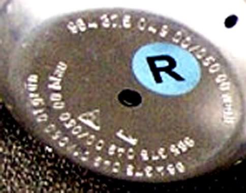

Yes, I saw that, but if you take the picture and blow it up, you can see the part number 964-375-049-00. (Somewhat irritatingly, there is also a 964-375-049-01 number for the C4 and 965-375-049-00 number for the C4 Targa/Cabrio and Turbo on the part!).
What's more interesting is that they put an "R" label on the -049 part that matches the "/L" part number in your PET drawing. I'd be interested to know how much a place like Sunset Porsche will charge for these mounts. Also, besides the front mount spacers and bolts, the FVD kit seems to have some concave spacers (maybe to go over the square "carriage bolt"-type area on the studs of the mounts?
