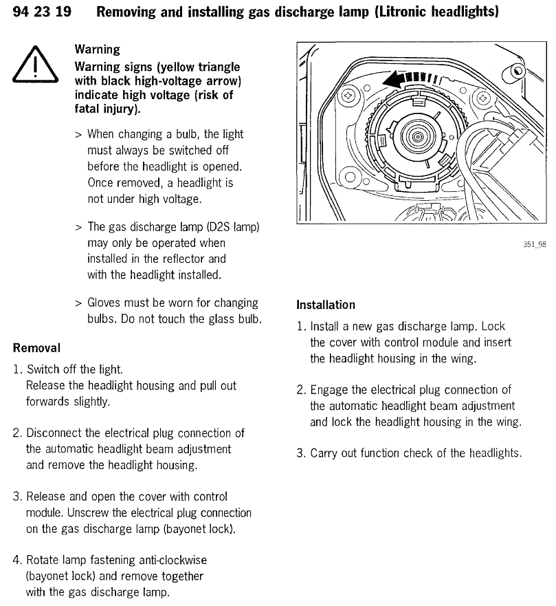

Hi guys,
I bought a pair of xenon light on ebay and like to change it to 8000K, but I dont have the manual for the light. (I have the bulb already)
I removed the headlight from the car, I can change the day time running light but the mount on the xenon light is hard and solid. I dont want to break it.....
Can anyone please post some pic how to change the bulb of the xenon light ? Thanks in advance!!!

Thanks ! Problem solved !!!! Thanks for your prompt reply !!!
