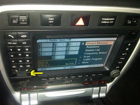

a phone module on a pcm, I have the same question i like to know if my car have it. my car is a cayenne turbo 2004 germany version and have the GSM TRAY in the PCM and the phone button in the upper part of the radio, but when i putt a gsm chip nothing happen, somthing else how do i know what model is my PCM ?
the SW version Say
3.0 pcm
3.0 System Software
6635 Device Type.
Thank for your help.
