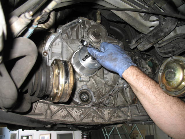

I was hanging around Marvin's shop on Friday watching him reseal a 1999 996 with140,000 miles. Marvin is meticious.
