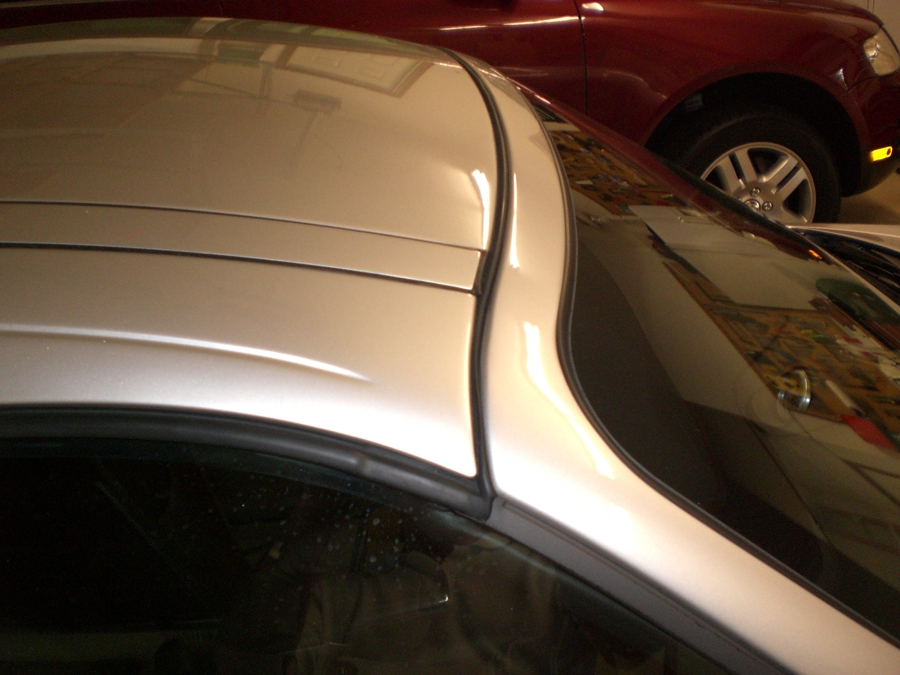

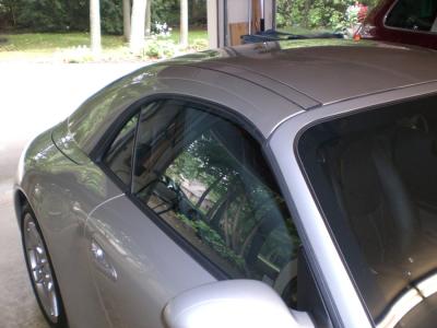

Update- 996 hardtop retrofit for 997
Update to my earlier 996 hardtop retrofit to a 997 C4S- Top fits perfectly. Total cost of parts was $ 250, not including the top itself. Job took all of 30 minutes to complete and on a difficulty scale of 1 to 10
I'd rate it a 1. Once that parts came in putting them on the car is pretty straight forward. Pic below show key fitting areas. Top fits snuggly and all mounting points matched up perfectly without any adjustments to the latch points. Top was purchased off ebay and was made in 2003.

Reinstalling the roll bar cover is the reverse of the removal. The cover has a channel along the front side of it to receive the trim piece that goes across the back of the car's rear bulkhead. It's easy to line up just ends to be done before you start screwing the roll bar cover back in place. THe smaller covers go in front first ( where the hard plastic positioning clips are) then push down on the backs to get them to seat in. I used the screw driver blade to apply some pressure to the springs clips to ease the covers back on. Just be carefull not to scar the fabric covering on the cover.
Hi, I have just purchased a 996 hardtop for my 2008 997TT cab---thanks to your detailed explanations I knew it would fit. I also inquired from Sunset Imports about the mounts, and they confirmed they would be $122.5 per, plus shipping. The only other questions I have is this: both 996 and 997 owner's manuals talk about fitting 'both protective covers into the trim panel' covering the rollbar, before installing the top; these are designated with the letter J on the diagrams. Do you happen to know the part number for those, as I do not think the top came with them? Many thanks in advance.
Most probable part number would be 996-563-421-01 as that's the only part on the PET that refers to protective cover and I couldn't find anything else in the diagram.
Edited by dphatch
Thanks for the post I installed the hardtop brackets on my 2004 turbo and it was a 1on a scale out of 10 job. Your step by step instructions were perfect. Thanks Jim
