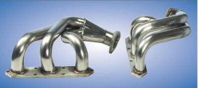

I appreciate your point but here in Switzerland the laws are very strict if people change cats.
In this case I prefer to change the headers and why not from Cargraphic (http://www.cargraphic.de/index.php?/s,6,7,18,1493,2125/) as shown below.
Mine need to be changed anyway due to the corrosion.... Loren would you recommends to replace the headers with the Porsche genuine ones or I can use the Cargraphics headers?
Thanks in advance for your help
