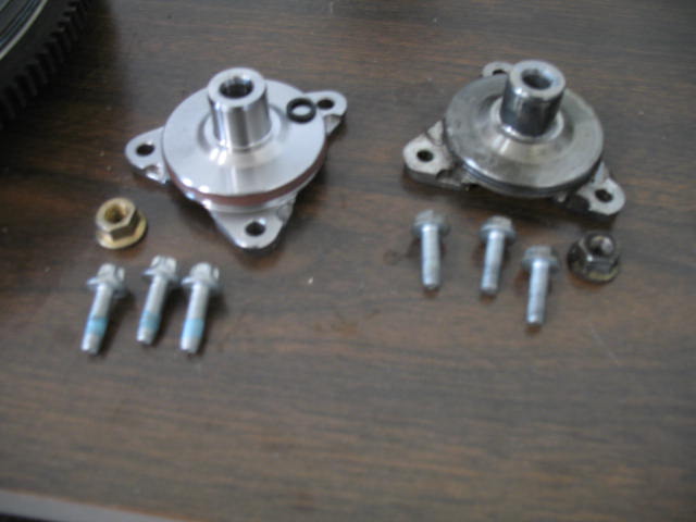

New style is on the left and old style on the right. The old style has a simple 0-ring seal. The new style has a better seal. The seal is part of the flange, so that is why you have to replace the flange if you have a leak from that area. You can also see the blue bolts on the left.

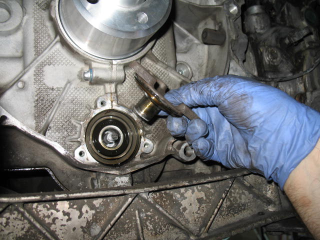

Second picture shows where the flange goes on the back of the engine. This is a 1999 996 and it had the old style.

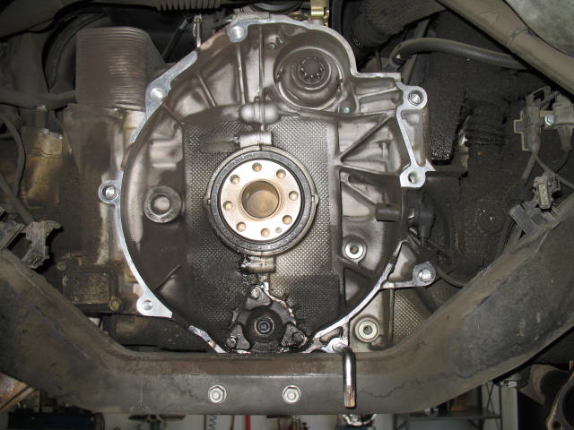

Last is my 1997. There was a film of oil on the back of the engine. Looks black because dirt sticks to the oil. You really can't determine the source. Is it the seal, bolts, or flange? That is why it is somewhat standard procedure to update all the parts on th older cars. My car was like this when Marvin called and I went over to check it out. In 9 years of ownership I never saw a drop of oil on the ground. So mine was not a leaker like others you read about. I was going to leave it alone but since I had 67,000 miles and Marvin was in there....
