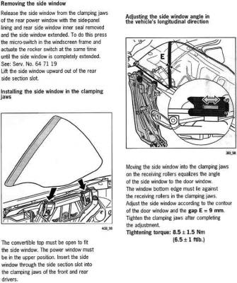

Thanks I believe this should help me out alot...I do have some questions real quick though or clarifications
I did everything else as stated but uncertain on these:
Pop off plastic cap in side panel (decorative Piece)
Remove side panel recognising there are lugs at the rear of the panel that need to be freed (pull forwards)
Can you explain if possible
Thanks
There is a plastic piece that just pops off (item # 7 in picture). You then slide the panel forward to get it free of the lugs and it just comes off....don't know how else to put it. I did it 5 times replacing my seat belts.

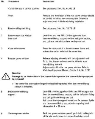

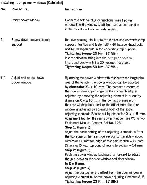

Thanks I finally got it loose and it came off as I needed too. Now its a little bit more complex than I figured it to be. I thought I would be able to see the window and its mechanism that operates it but it seems to be covered by the Soft Top Mechanism!
Are you familiar with how to get to that sliding window and its railings so I can take a better look at whats going on???
Thanks
How's this?
You are the man!!
But by looking at it, it doesnt show me how to get to it....its blocked by all the softtop mechanisms I cant see the clamps its talking about. Also Ive been told that on these Cabs the Regulators tend to go bad very often so Im assuming thats what Im going to have to replace. Do you have anything on that?
