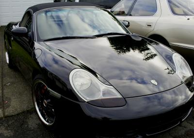

I've been looking at rims to put on my 00' Boxster S 3.2L 6-speed which has factory 18" rims now, and I think I've decided on a style. The rims are 19x10 and 19x8.5, what Tire size would I need for this application to work ensuring there's no rubbing, and doesn't effect the spedometer etc.
Thanks!
U would need 235/35/19F 295/30/19R

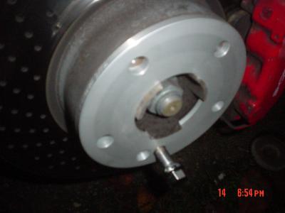

most likely will need 2 pairs of 7mm/F & 14mm/R hub centric spacers.
