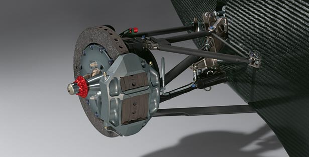

How about the Porsche RS Spyder?
No slots or cross-drilling.
Well now I have seen one. Are those carbon rotors? Good God man.
:notworthy:
Porsche RS Spyder
"Two-circuit hydraulic braking system, six piston aluminum monobloc brake calipers, front and rear ventilated carbon (ceramic) brake discs, F: 380 mm diameter R: 355 mm diameter"

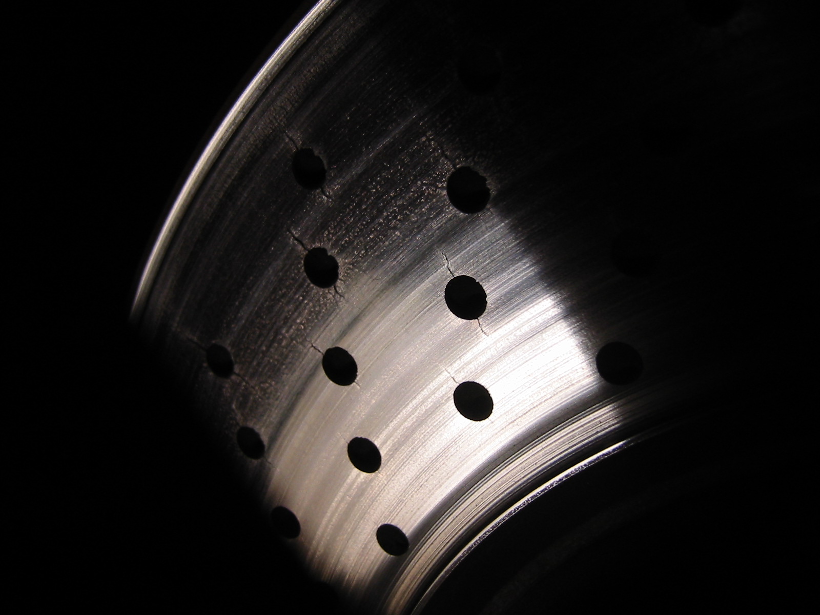

Two GM engineers tested 2-3 cross-drilled braking systems and 2-3 solid-face braking systems. The pictures blurred anything on the rotors that could identify the braking systems they tested. It's a 28 page analysis/report with quite a bit of technical mumbo-jumbo.
They made a few observations (including the obvious of cracks developing around the holes), but the one that pertains to my reply is that cross-drilled rotors do improve brake cooling over solid-face rotors. Furthermore, the cooling rate increases as speed increases.
Of course, rotor design also plays an important factor. It is possible to put too many holes in a cross-drilled rotor or place them ineffectively.
