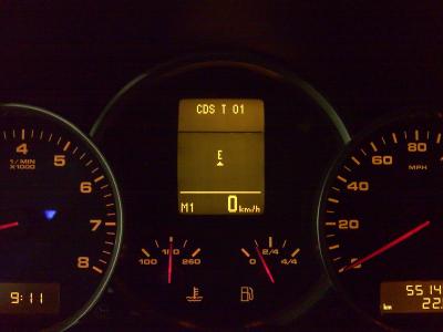

However, the other day, a friend of mine with a 2003-2004 PCS came to me to clear some error codes, and what I discovered is that he had this function running even if he didnt have the PCM installed; the car came with the CDR23 installed. So, I assume that the GPS antennas are allready in the car? On the main gauges settings, there was also a setting that allowed you to run test and callibrate the COMPASS, so that I had to drive the car in a full circle, and it worked.
Anyone know how is this possible?
the picture that I tooked doesnt show the actual configuration, but I will get another one in a few days to show all the dashboard.
My 04 CS without nav has the compass (same as in your pic). If you look at the order guides available on this website, they were only an $80 option. And yes, there is a recalibration selection in the menu, not that I've ever used it. I am not sure having a compass requires a GPS antenna.
