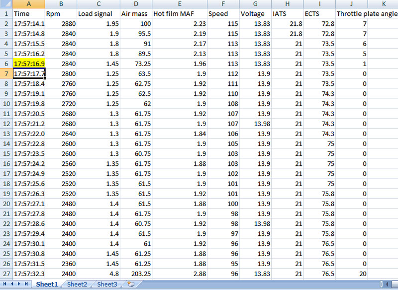

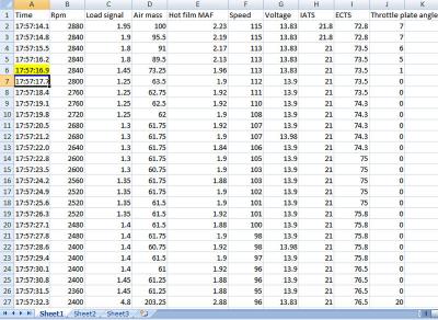

I ran the Actual Values on my commute home from work. Surprisingly, the car cooperated by hanging idle for the first 20 minutes and then returning to normal. Here's a sample from each section. When the throttle percentage is 0, I was clutching and letting the car coast.
When it hangs, I get triple the air mass kg/h along with generally lower Idle Air Temp Sensor and Engine Coolant Temp Sensor values (although in the complete Excel file, the hanging/regular temp values overlap some, so I don't know if that's a factor).
Anybody know what this means?
Are there other values I should monitor?

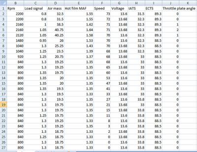

I logged more data yesterday evening, but I haven't had time to go over it yet. A few more pieces of info ...
When the idle is hanging and I'm at speed, but take my foot off the gas without clutching, instead of slowing the engine the car continues at speed like it's on cruise control, but with some surging. The surging is much more pronounced when the temperature is under 50 degrees F outside. I really hadn't noticed it when the weather was warm.
The problem starts and ends only when the car comes to a stop. (Well, basically a stop. It has to drop under 10 mph, which seems to reset the computer to the idle circuit and drops the rpms to 800.) If I'm on the freeway, and the car isn't doing it, it won't randomly start doing it unless I either come to a stop in heavy traffic or get off the freeway and come to a stop. Then if it does start, it will keep doing it until the next time I come to a stop. No variance in speed (aside from dropping below 10 mph) or amount of clutching will get it to start doing this or to stop doing this once it starts.
The only consistent factor is that everytime I come to a stop sign or stoplight, it's a crapshoot whether or not the engine will do this until I stop at the next stop sign or stoplight.
This problem started about a week after I had my spark plugs and oil changed back in July. I didn't think it was related at the time, but going back over my receipt I saw that after "Spark plugs" they mention "Slight tuning." I'm wondering if this isn't completely computer related due to Firestone's attempt at "Slight tuning" and if I should go have a Porsche specialty shop re-tune it.

The chart above is from last night's drive home with the last time the rpms hung and then the first time the car started running normally. Notice the trigger to the change was my speed dropping to 5km/h.
Looking at the Actual Values logs from the past few days it looks like when the problem is there, the voltage on the 02 sensors ahead of the cats fails to drop to zero when I clutch. Once I hit less than 10 mph, the voltage drops to zero and the idle returns to 800 rpm or when the car is behaving correctly and I clutch at any speed with my foot off the gas, the O2 voltage will go to zero and the engine returns to 800 rpm.
Along with the O2 sensors dropping to zero, I've also noticed that when the car is behaving correctly the MAF will drop into the 1.3 - 1.5 range, but I'm guessing that reading is dependent on the air flow, not the cause.
So my question is, what sensor or switch creates the fuel cut off or new programming loop that leans the mix and makes the 02 sensors blip to zero when I clutch, so I can fix it?
