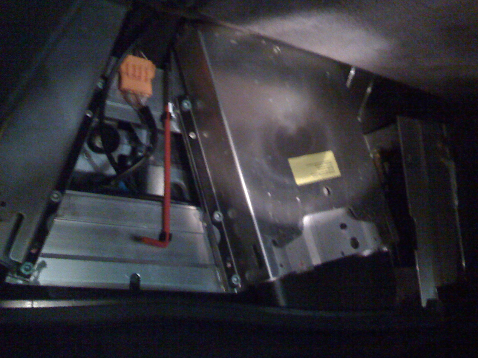

I was going to inspect and clean the connections at the DME. I'm a bit confused. I thought it was behind the seat, but all I found was the rollbars and top mechanism.
Am I looking in the wrong place? If it's under the seat, how do I get that bottom part off? Do I need to remove all the seatbacks and all the seatbelts?
The DME is located under the clam shell/soft top, remove the trim (carpet) with the soft top in service possition and you will find the DME mounted in vertical possition behind the roll bars.
