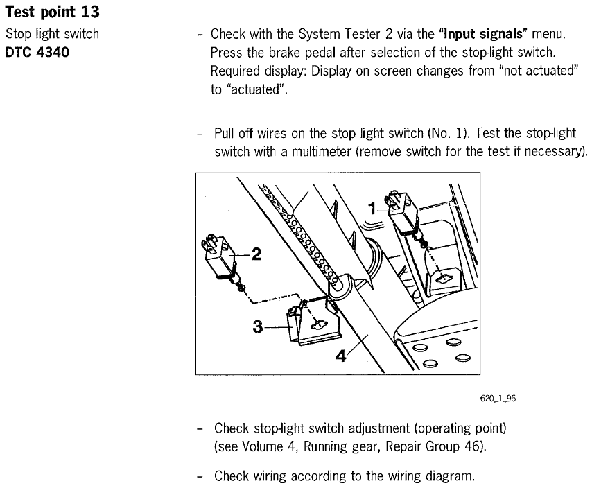

I checked with my Durametric software and got the following faulty code.
4340 stop light switch
P0571 Porsche fault code 364-Brake pedal position sensor
I already changed my stop light switch. But still getting the fault code.
Does anyone know where the brake pedal position sensor is and how hard is it to change out?
The brake switch # is 996 613 113 01 and should have a brown colored body top.
that is the correct switch i got. Part number is correct. what is the Brake pedal position sensor in one of the fault code?
