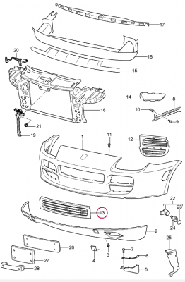

I need the part number for the center grill on a 2006 Cayenne S Titanium edition. I hit a deer and broke the grill. It appears to be the grey Titanium color. Where is a good place to order this part? From what I searched, I believe I have to remove the bumper in order to replace it.
Thanks
Randy
955.505.683.00 grille -- US MSRP $64.58
It either comes unpainted or they are all the same color (it does not specify).
Replacement is pretty much the same process as I described in this thread
Thanks you very much Loren for the part number and the directions. It was a less expensive than I expected.
