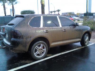

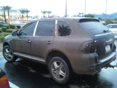

I found some mud in my CTT.... street tires are very slippery in deep mud :D
I had the PSM off the whole time i was pulling doughnuts and drifting like a mad man, then i turned the
PSM back on and i could feel it braking the wheels that were slipping but i was not able to go very fast
cause the mud was sooo slimey that it took a lot of wheel spin to get moving.....all it good fun B)
