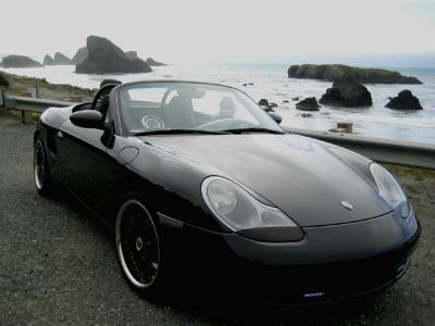

I got a set of your second option on my 986S. Yes U can believe what he is claiming, rear lip is actually a bit more than 3".
both wheels will fit fine, may need a pair spacers on the front.

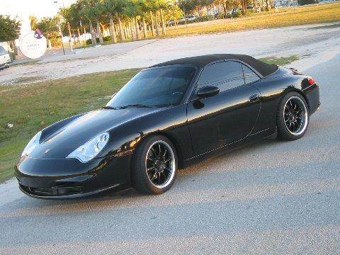

Thanks juniinc for that photo :). That second set was my first option actually, because I used to like the SSR GT3 rim and the company seems to have vanished.
Front:
18x8.5 et52 - 26lbs - 1.5" lip
Rear
18x10 et58 - 28lbs - 3" lip
Whereas the first set would have been a couple lbs lighter thats all.
a. Did you get it from the same place (usarim.com / eurotech wheels)?. I had a friend of mine in San Diego, check the shop out it seems legit.
b. The second rim dealer said its a standard offset for the 911 in the front and it should fit with no spacers
c. The rim that you have is it a truly polished lip or is it a stainless steel snap on piece?.
The usarim guy is really slow in response to emails.
anytime RC, great choice by the way
a.yes Eurotech wheels(life time warranty)
b.That's what they told me too-my stock offset was ET50, 2mm was barely rubbing
c.not a SS snap on piece, truly polished chrome

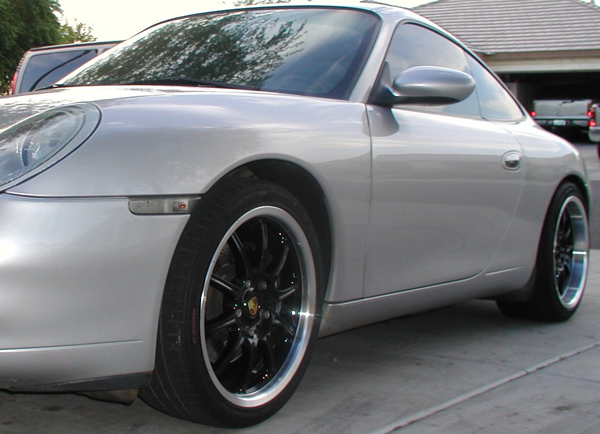

Nice ride!. Is that 18" or 19"?, according to usarim.com they recently came out with the same rim in 18". How did you order?. Online / Phone?.
You might want to check out www.wheeldynamics.com I bought some wheels from them a year or so ago and they had a good selection and pricing was very good. Service was top notch. I have no association with them other than a customer. The guys there are very familiar with Porsche's and if they tell you it will fit, it will. My wheels are 18x11 rear with 63 et and I am running 285/30/18 tire with no rub issue. My car is a MY 99 C2 Cab.
Will
Thanks :D .
they are 18" I get that question all the time 18'' or 19"?
I ordered online then confirmed over the phone.
