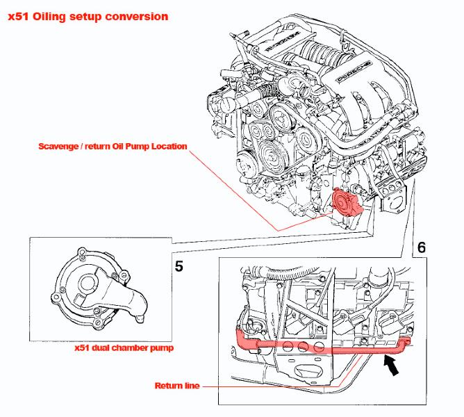

All,
I'm in the process of installing the X51 Oiling mod that was offered on early ROW 996's 99-02. This was a PMNA mod for competition that provided lubrication to cylinders 4-6 in long extended left hand turns on the race track. Im needing specs on machining for the oil return tube and attaching hardware. Any one gut any clues. This was a very rare installation and only came on the early Euro sport 996 with M96 3.4 Engine.
Someone said this might have been in a TSB, but the information is seriously out of date by todays standards. PNMA no longer offers this as a modification.
I no one knows about it Im sure I'll get by as its just basic engine machining techniques.

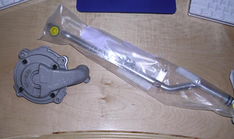

I will post a write up on this installation when I get my parts in. At that time I will inform the board where I found the scavange pump kit and the avalibility of any others.
I have been told that this is not a a total fix to all the oil lubrication issues that come up when tracking a 996, but it is a start in the right direction ,if you want a 996 to operate reliably on the track.
At this time I would just be curious if anyone on the board has performed the X51 Oilling modification.

Here is the little info that I have saved on this topic that someone else posted a while back ago on another forum. Hope it helps.

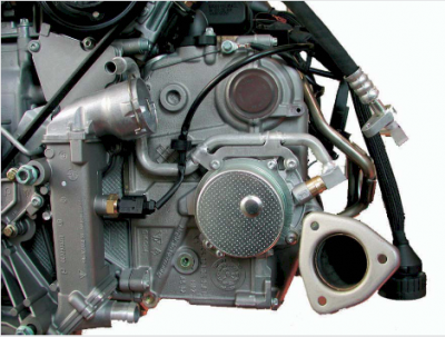

From the 997 Technik book...
"The 911 Carrera engine employs a mechanical vacuum pump instead of a conventional sucking jet pump to provide the vacuum for the brake booster. This pump is driven in tandem configuration together with the oil extraction pump of the right cylinder head by the exhaust camshaft of the right cylinder bank.
This design enables a high and constant level of vacuum supply and subsequent effective brake boost even when the most unfavorable underlying conditions apply, e.g. low external air pressure at high altitudes, and in highly dynamic driving involving a high proportion of full-load operation, e.g. on race tracks."

Thank you for the reply. I now understand that there is a different pump used on the M97 vs. M96 and that it should provided superior vacuum for brake boost, but what does this mean for the oiling system. Can a secondary return line, similar to the PMNA part for the M96, be installed on the M97?
It appears that this revised "tandem pump" makes use of the old M96 pump impossible, but is there a way to add a similar return line? Is this already built into the head/valve cover?

did you complete the x51 oil pump install? Pictures and detils of the maching of the vavle cover please
Thanks, David
I want to do this mod on my 02 3.6
