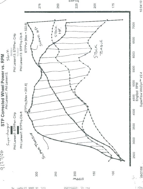

- Supercharger or turbocharger (here the consensus seem to be with TPC and VF-Engineering, both being around 12.000$)

TPC supercharger and because he was one of the first, he
said about $8,000 dollars. TPC might be worth
a call and you will need a local shop to
put it in. Most of the work invloves
adding the center radiator for cooling
the supercharger.
Paul
What about reliability with these superchargers. I've been in the turbo world until now so I don't know anything about superchargers but what thrills me the most is the lack of lag ! Any other downsides ?
Also...are there any other mods needed besides this supercharger kit (like rods, pistons...) ? How will the Tiptronic or deal with 500HP ?
Edited by fuscobal
My car is a MY05 997C2S TIP and it handled the TPC SC kit well. I already had the center radiator, so I did not need that. Car was a daily driver and is a rocket - over 500hp and 400+ TQ at crank. TIP was ok, but first 2 gears are useless - car is soooo fast. However, I'm looking to trade up to a 997TT and had to de-mod my car. TPC SC kit is for sale - $7,000. Professional installation is recommended - around $3k + any parts needed.
