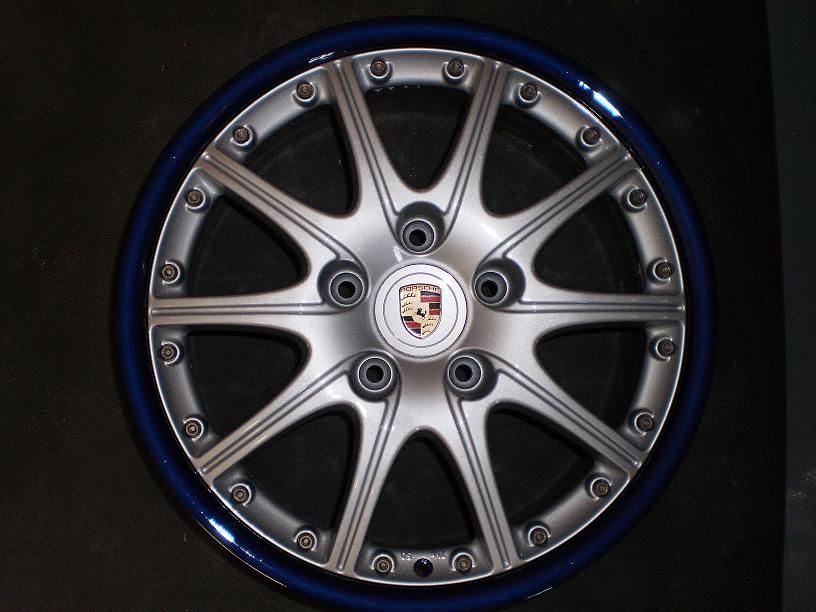

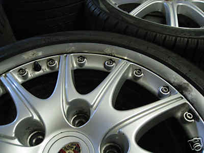

Resurrecting this thread - many thanks for the original post - a great write-up. I just finished refurbishing mine. Fortunately for me there were no broken screws upon disassembly.
Also, I went a slightly different route - I had the center sections powdercoated in black, and polished the outer rim. The tires will be mounted tomorrow:
Pics before:
There was a bit of corrosion on the rim:
After polishing:
The final product:
