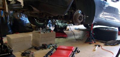

I'm in the middle of a clutch replacement and 60k service.
The local dealership quoted $2,200 for the 60k service alone.
Everything is disassembled, I'm just waiting on the parts.
I ordered everything in the bell housing including flywheel, plus RMS, case bolts, IMS bolts,
plugs, plug tubes, belt, filters, transmission mount, overpriced Porsche grease, and the RMS installation tool.
It came to a little over $1,800. I figure I can sell the RMS tool and get a little back.
I also bought a few tools, a floor jack, a transmission jack, four jack stands, and that was around $400.
The only snag I've hit so far is the transmission mount. It's pressed in. I couldn't get the gbox out from under
the car while it was on the jack. I thought I'd cut out the old mount out and try to McGyver the new one in with C-Clamps.
But It's in there quite snug, so I surrendered and wrestled the trans off the jack and slid it out.
So far It's been pretty straight forward.

Definitely a good safety practice to place the wheel and tire under the car as a back up to the jackstand as Foster has done.
