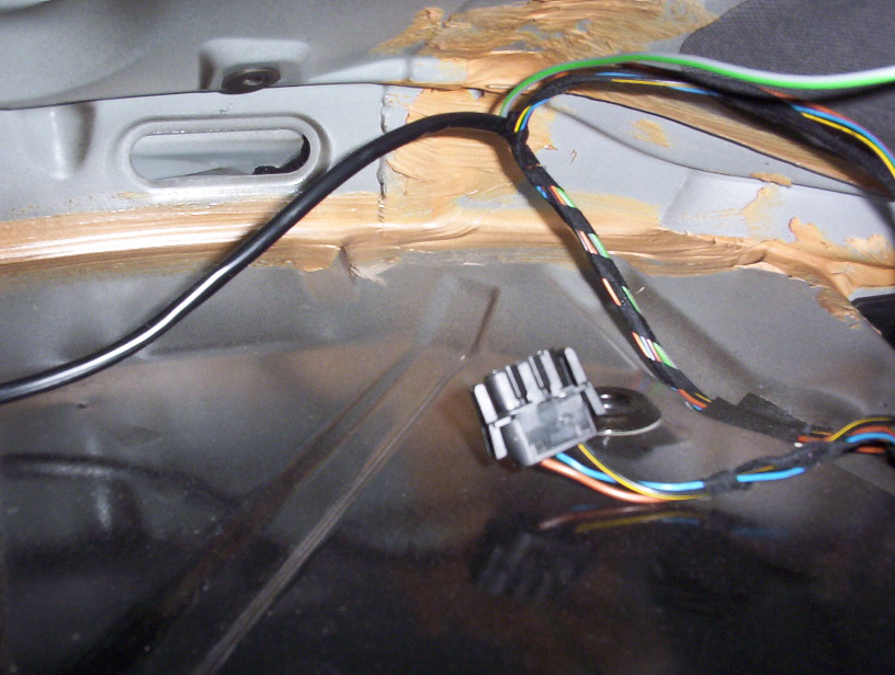

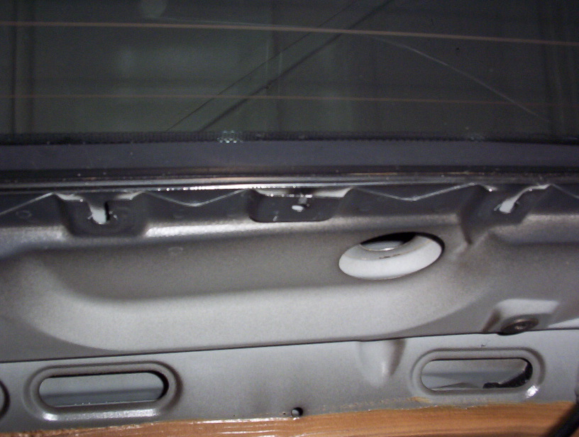

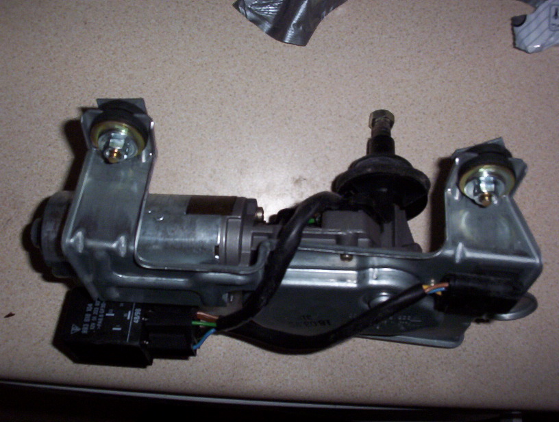

For anyone interested - this is from a 99 996 - installation is simple as it just bolts onto slots seen in the pics - As Loren says, problem may be that the wiring loom may not be there (incl the dash switch) so check this first.
Motor :
Motor end loom :
Fixing to the body shell :
