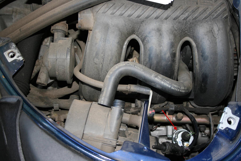

The sensor is located between cylinder 5 and 6 ( passenger side LHD car) on top of the cylinder head. Remove the shield in front of the spark plugs, bend an open 19 mm key to 90° to remove and install the sensor.
Thanks again for the help RFM and Loren. I did the swap, but found a slightly easier way to reach the oil pressure sender without lifting the car or pulling the spark plug coil heat shields. I found, while detailing the engine bay, that I could reach into the bay up to the oil pressure sender on the passenger side of the car. I happened to have a set of crowfoot wrenches that go with my torque wrench. They are about 50$ at Sears right now. These look like the open end wrench head, but can go on an extension bar like a socket. By reaching in with the crowfoot on a 6" extender, I could get the wrench on the nut at the bottom of the sender, and used my wrachet to loosen the socket after unplugging the two wires on top and unhooking the battery. I then unscrewed the old by hand and screwed in the new to finger tight. I then tightened the new sender in the same way ~1/4 turn and re connected the wires. It looks like it's working fine!
