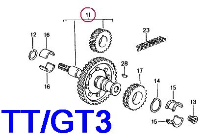

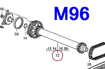

Just so everyone is clear, these two pic's show the intermediate shaft for the TT/GT3 (and all air cooled 6cyl Porsche's for the last 60 years) and the intermediate shaft for the M/96 engines (which has ZERO in common with the air cooled or late 993 engine based water cooled engines)
The TT/GT3 shaft VERY VERY rarely fails. It is not in a sealed roller bearing like the M/96 based engines. It literally sits in what amounts to 4 bearing clam shells. What you do not see in this pic is the shaft running the oil pump.

What I understood from a Porsche technician is that the problem seems to be loosening of the bolts that secure the gear on the shaft. Whether this was from improper factory torque settings during assembly, inappropriate strength bolts, or a design flaw of some sort is unclear. The failures are relatively rare but disasterous for the few that have it.
Share this post
Thanks RoadsterDoc :)
I *thought* ALL the aluminum gears were riveted on ??? Maybe that was only in the race engines? Now I need to dig out some parts!!
