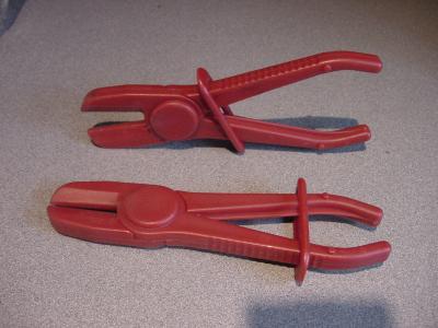

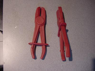

Shihman:
Here are two photos of the pliers. I think the formal name for them is "radiator hose pinch-off pliers":
These are a cheap plastic version of the more substantial and expensive pliers, but they work just as well for this application.
You just slide that little plastic ring that is around the handles forward, open the jaws of the pliers wide and place around the radiator hose, then squeeze the pliers and pull that little plastic ring back to lock them shut.

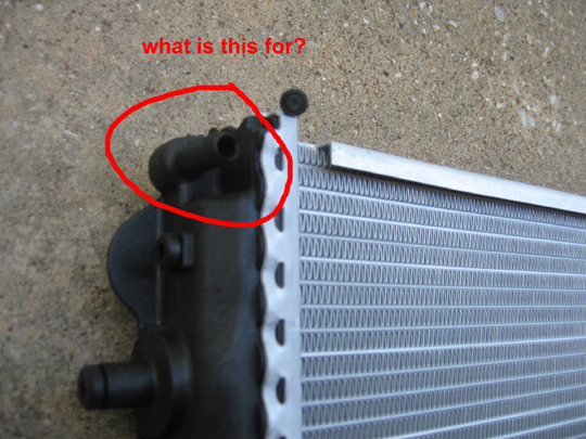

oh yeah, studying the new radiator and found a short stem on the back side (see pic) then went to look at the attached radiator and saw a small tube is connected to it. what is it?

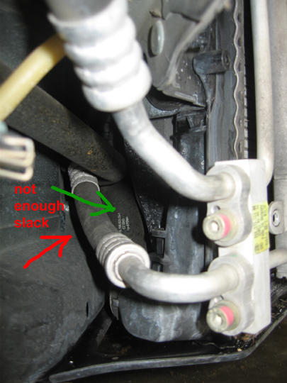

Look at the photo on the left that is on the bottom of the first page of this thread (that Bobiam submitted). That left AC radiator is easily out of the way. Look for fasteners. You'll find them. I think there are some slide clip fasteners holding one of the radiators on. At a glance they look tricky, but are not really. You do have the inner fender off...right?
There is some metal frame towards the back of the radiator that I recall removing that supports one end of the radiator system. There is really no problem with the length of any hoses. Look again at the pic that I previosly posted and take your time identifying fasteners. It is a project that requires patience. you certainly don't want to remove all that hardware again!!!
Regarding that little plastic tube in your photo, if your old radiator has one, you're in business. I can't recall it or what it's for, but I'm sure it's nothing to worry about.
