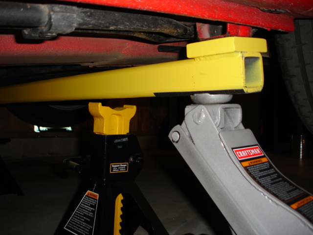

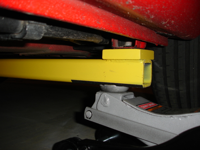

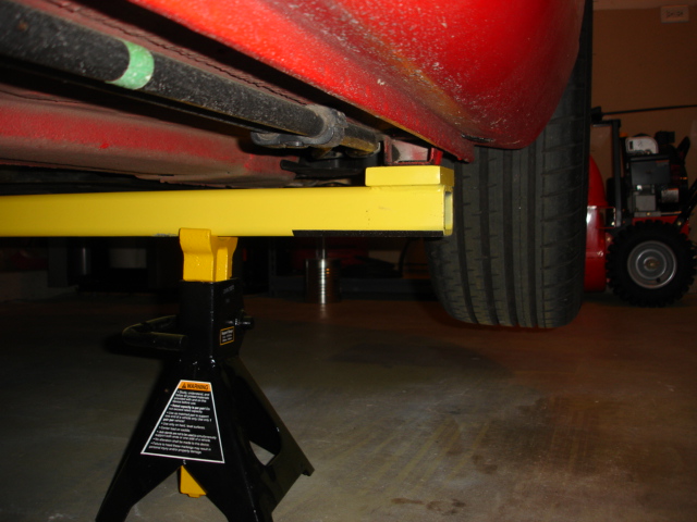

I chocked the back wheels and jacked the entire front of the car first. I used two floor jacks and raised the front corners in equal increments. So the first two jacks stands were under the front and the rear tires were still on the ground. Then I jacked up the back also in equal increments. So the car went straight up and straight down. The car was never leaning at a sharp angle. I do believe that you are correct, if you raise from side to side you will create such an angle on the opposite side that it might be impossible to get your floor jack under. That is why I don't think bars from front to back would work. With these bars the car is jacked up in more of a LINEAR method than a twisting one. I attached this picture of just the front end supported and the back wheels are still on the ground. Hope this helped. Jim post-35646-1236522033_thumb.jpg

Hey guys- These new bars work great. There are a few ways you could use them. Here is how I did it today.

What a great idea. What did you use for the part on the pad that goes into the slot on the car?
The part that goes into the slot on the car is a piece of 1/4 inch thick solid steel that was welded to the pad.

that looks a bit unsafe. What prevents the bar from rolling?
