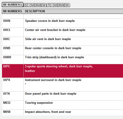

Can any body tell me what kind of interior is this by the vin
WP0CA299X1S653495
the reason I asked because I am looking on ebay and looking for some replacement like interior trim and steering wheel
And actually is there a steering wheel that would fit the correct color combo of this car., The original steering wheel is a tan/beige color 3 spoke with wood tiptonic (that is cracked)
but I would like to know is it actually a Tan color or a Beige color
the car is a MY01 C2 Convertible
You could special order natural brown and some other colors, but Svanah Beige was the only tan available. If you are interested I have a Savanah Beige four spoke wheel and airbag in perfect condition.
I already have the a 3 spoke wheel and airbag but the wood is cracked thats why I want to change it.

6 speed or Tiptronic?
Wood color?
Its a Tiptronic, I think the wood is Dark maple or something

I had your VIN run and your option code for the steering wheel is IXPC.
So your steering wheel is part number 996.347.983.11.S40 Tiptronic steering wheel with dark burr maple and Savanna leather.
Are you sitting down? US MSRP $1159.86
Check with Sunset Imports (Porsche Parts at Dealer Cost) for much better pricing.
Thanks Loren., What are GREAT expensive price that is.,.,
