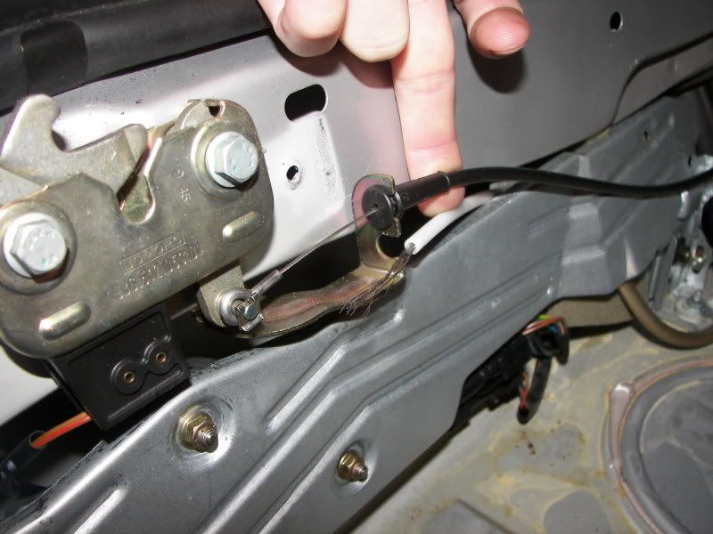

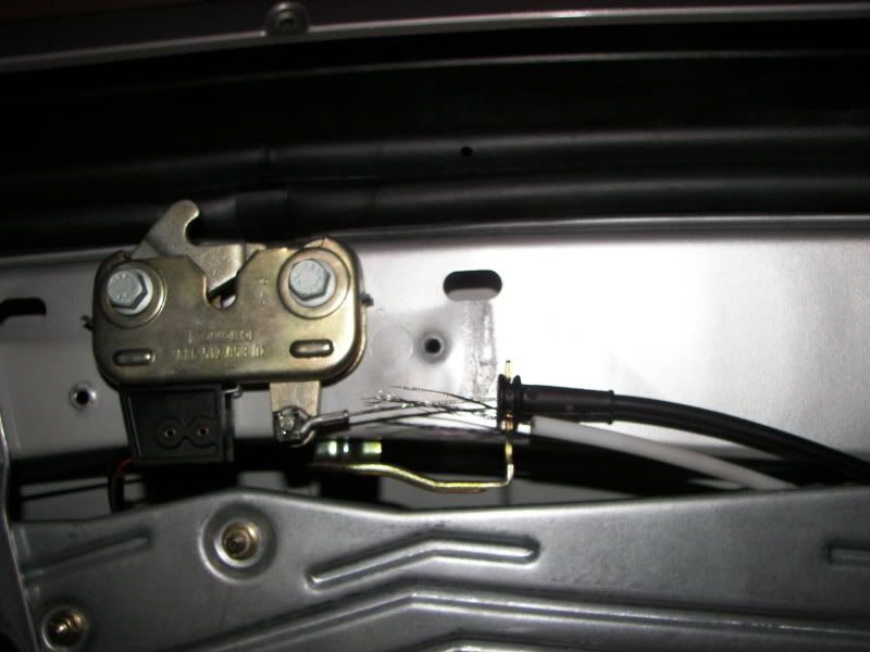

Well, I pulled back all the trunk liner to expose the locking mechanism and cables. The "black" bowden cable is still in tact working fine. The white one, that i'm point at is the one that's busted, I already emoved the white plastic retaining cip that sits below the "back" bowden cable. Unlike the black cable however, can not trace where the white cable actually goes. it looks like it's tucked back under the metal restraining bracket for the spolier, which looks to be bolted in pretty good... What i'm wondering is, is the cable that's actually snapped in the picture the culprit for why the remote button doesn't release the trunk? OR... is this cable something else, a.k.a. emergency release cable? :help:

Oh... your car is a 2000 so there is no motor - it's all mechanical cable pull.
There is a short emergency cable and the longer manual cable that attaches to latch.
Hmm... ok, so then looks like I have 2 problems. The emergecny cable needs replacing, which I am guessing has no relevance to why the "remote control trunk release button" wouldn't be opening it.
So then... if the latch operation works fine which we know is the black bowden cable. And when I hit the trunk release button, I hear an electrical motor like i usually do, which pops the trunk (but now is not). I'm still confused where the real culprit is then?
:unsure:
there should be 2 cables attached to latch pull. One is from the lever in the cabin, the other is from the remote motor which is activated by the key fob. It may too be connected to the emergency release but I'm not sure.
Anyhow, as you've found, these thin wires can break over time. Instead of running new cables, here's how one person fixed theirs:
Fixing frayed/cut trunk release cables
The motor is located in the left rear trunk corner, packet in foam, behind the plate.
