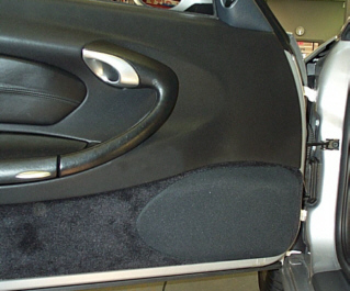

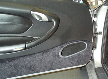

Any good shop (like ) can modify the door panels.
http://www.caraudioinnovations.com/install...santiago996.htm
that's helpful thanks. are the grilles in your photo a factory part, or fabricated? i understand that he door will need a mod in any case.
Those grills are fabricated.
I don't think the factor grills will work that well since they are to be used in conjunction with the stock bass enclosures and speakers.
