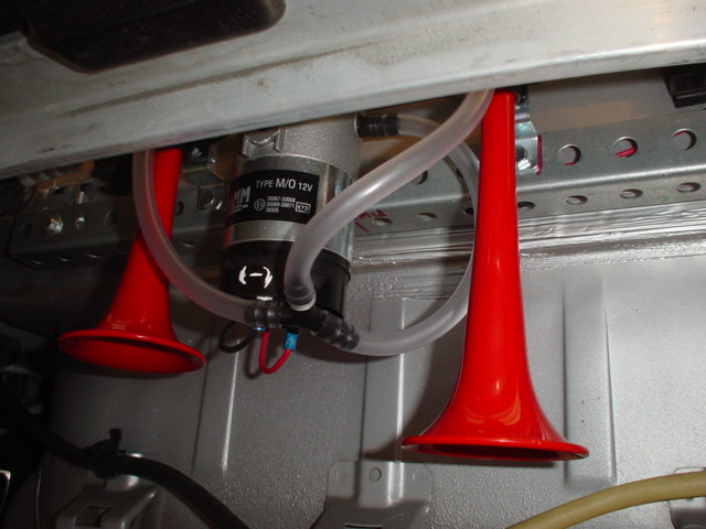

A truck backed up into my Boxster and the driver could not hear the horns.
So before the body shop put the new bumber cover on I took the car home on Friday and looked at the local parts places for the loudest horns I could find. Ended up with air horns. Put the air horns in and brought the car back to the body shop on Monday.
I added the air horns to the original electric horns. So now I have 4 horns. There is a lot of room on the base Boxster because we do not have the middle radiator. Should also be a lot of room on the 6 speed 996.
Do you know who makes them. I bet I could get at least 4 sets of those horns behind my bumper cover.
And what happened to your original horns.
Taught about putting in two of them also but it would be too much. They are made in Italy and bought them from that sight. Very highend stuff, lifetime warranty. Just was not happy with my horn, like the old style horn from porsche and was looking for the same sound.
