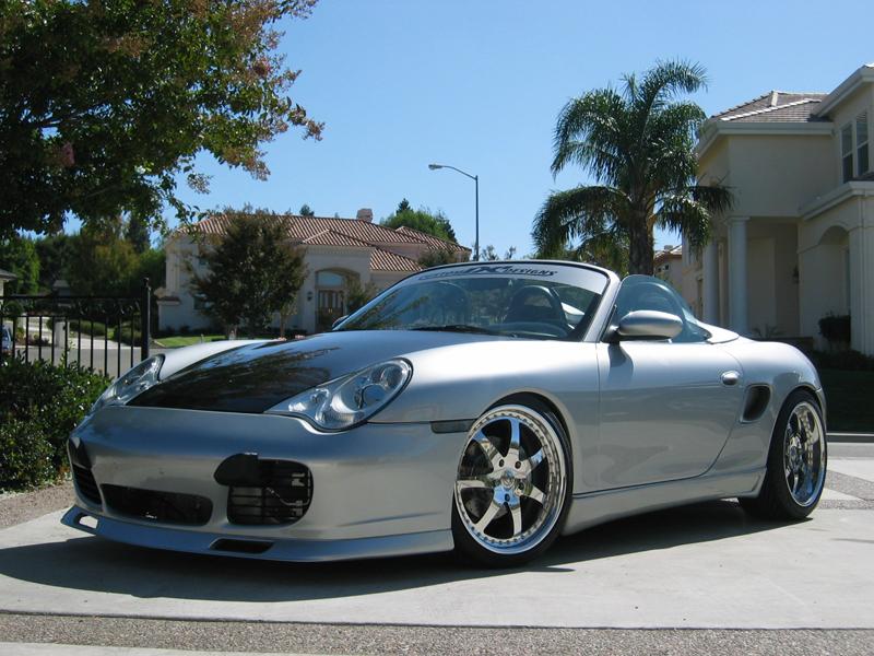

One of out local Boxster owners, Danny, has a turbo front on his. He used the halogen new style headlight and ran jumper wires from the connector to the new headlights. Because, as you know, the electrical pins on the back of the headlight do not match your plug for the headlight.
What you could do is order the front trunk wiring harness for a 2002 or newer 996. Which harness to get depends if you are using the standard halogen or Bi-Xenon. Xenons have more pins and so they have more wires in the harness.

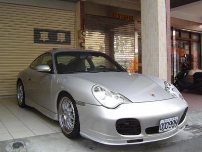

:D :D :D Finally Conversion has been done. Looking for a big wing to suit the car now.. any suggestion? ;)
Edited by barchetta
I am also doing the face lift on my 1999 C4. Do you have the wiring diagrams for both the headlights. (MY99 standard and 02+ zeon). I had the luck and found the wiring plugs so that I did not have to buy new harness. Buy the way it looks great and carrera wing will look great on the car. I will post some pics of mine when I am done.

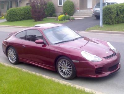

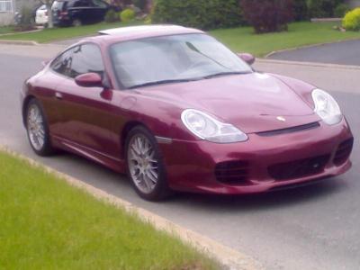

Ive started the facelift, got all the parts I and am taking pics for a complete DIY that I will post
very soon. Body shop has the parts for prep. and Ill take my car in for the swap and complete
paint and wiring next week. btw I have an extra set of the wire you need to do the
facelift. PM me if interested.
