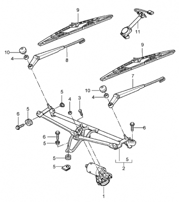

Flip the windshield wiper stalk and the wiper arm lurges 'down' about a half inch and stops.
So it's going completely in the wrong direction (for a half inch)......any ideas welcome.

Result here was a bad wiper motor......defective and shorting since day one.
The electrical short was present immediatly with ignition on........pretty hot.....could smell it....could have been a hazard.
Replaced under warranty.....done.
