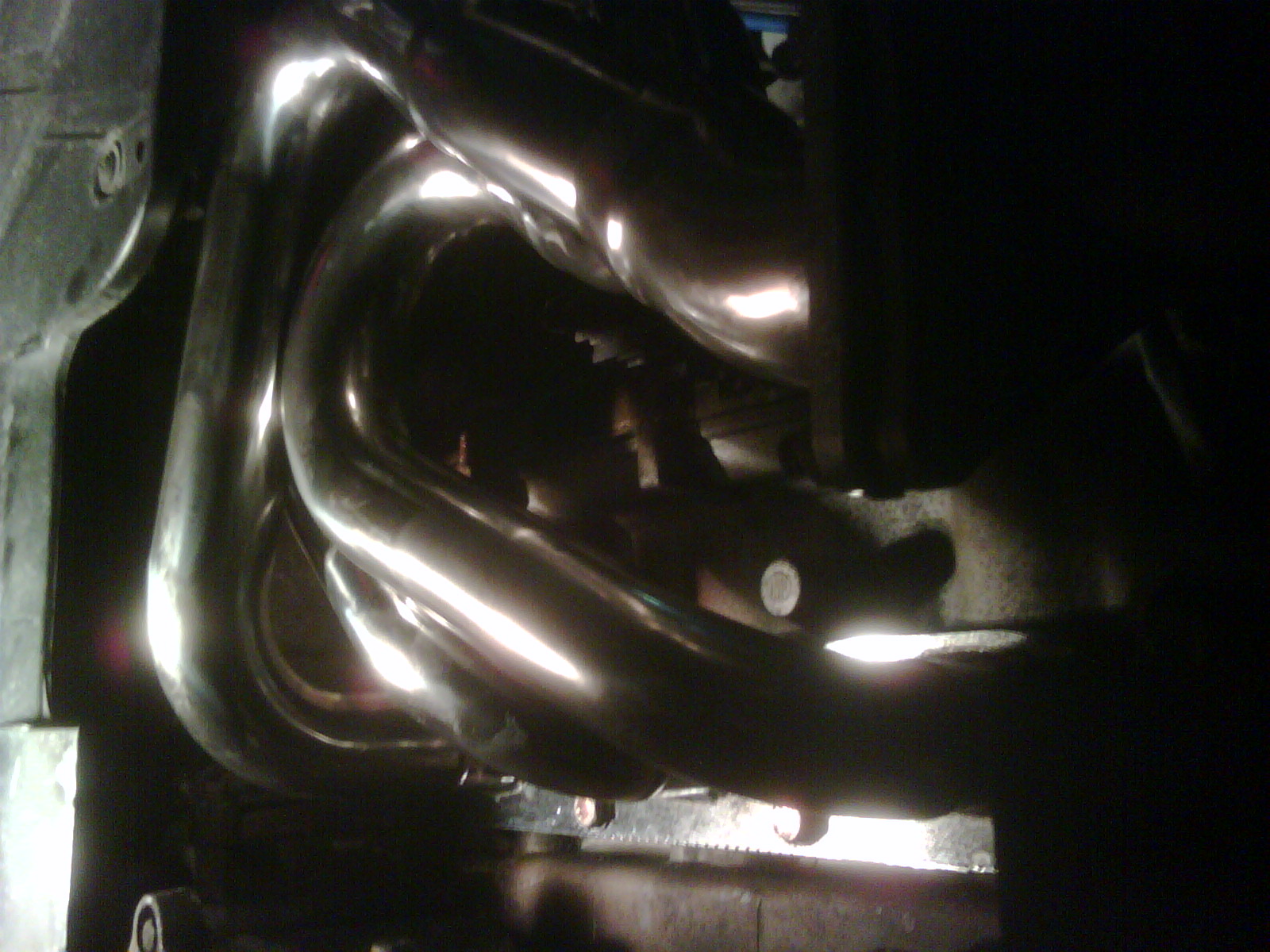

I will say very plainly that headers are MUCH easier to install than a muffler is on this car. I was actually quite surprised how easy it was to take off the old header and put the new one on. I used PB blaster on all the bolts and let them sit for ~1 hour before removing the old bolts and not a single one gave me a hard time. I did not expect that at alllllll. :)
To note, the Turbowerx headers have 2 bolts that are very tricky to tighten with a ratchet and likely will need a box wrench to tighten down all the way. The plastic shield on the passenger side of the car I loosened up to help get to them. That was a simple removal of 2 screws and 2 nuts.

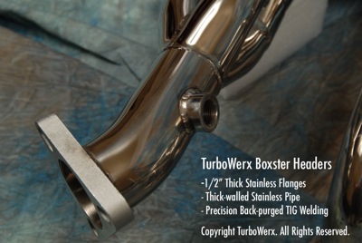

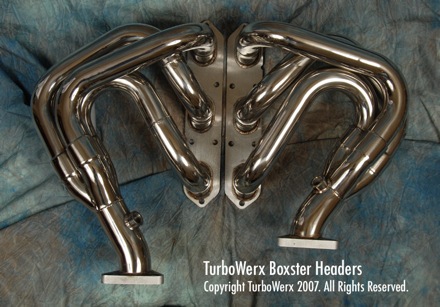

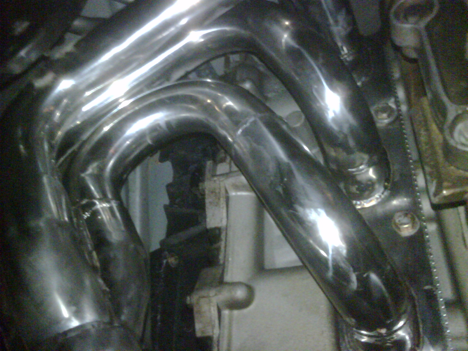

All I have to way is "wow." I have seen a number of headers in my day and none are the quality of these! I spoke with the company and the guy said he does them himself, although he outsources the flanges, he does all the welds and developed the tubes himself. Impressive and made in America! Woohoo!
The steel is beautiful, the welds are perfect and clean, and the flanges are very thick (1/2"!!). The F1 merge collectors are the perfect choice here also in my opinion. Bravo all around.
