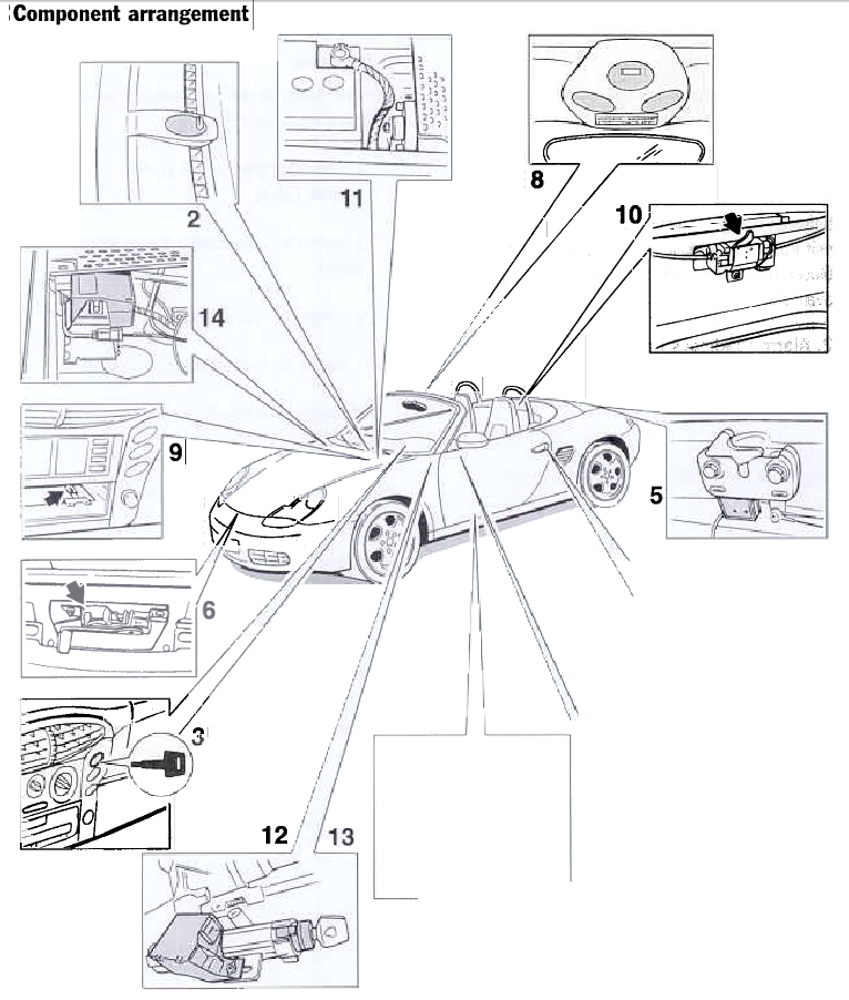

How many zones are there? And what are they?

Couldn't wait for the dealer so i opted to buy the durametric software.
This is what it found: Not quite sure where to go from here. Even if i replace a broken part i will still need the Porsche Computer to reset the codes won't I?

Clear them and see which come back (after locking and unlocking).
I suspect it will be fault 33 Interior sensor faulty.
