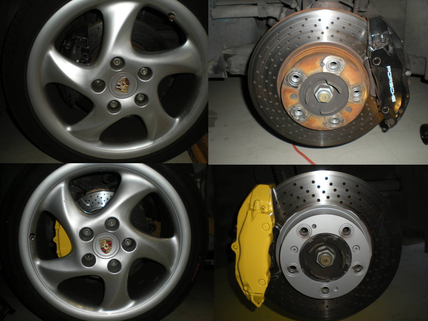

I don't know if anyone have rusty calipers, never see ones.
This are the pictures i'm referring from. thanks to JeTexas for the referral. Hobbes post look what i'm looking except for the calipers.

That was my results. :)
sorry for no previous pics.

Hi. As you have read on the other posts don't paint the actual disc surfaces, just paint the hubs or "hats". For my discs I degreased the hubs and sanded them lightly. I sprayed them with Rustoleum Cold Galvanizing. This is a high zinc content grey primer. I have not had any rust in 3 years. I hope this helps.
