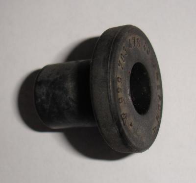

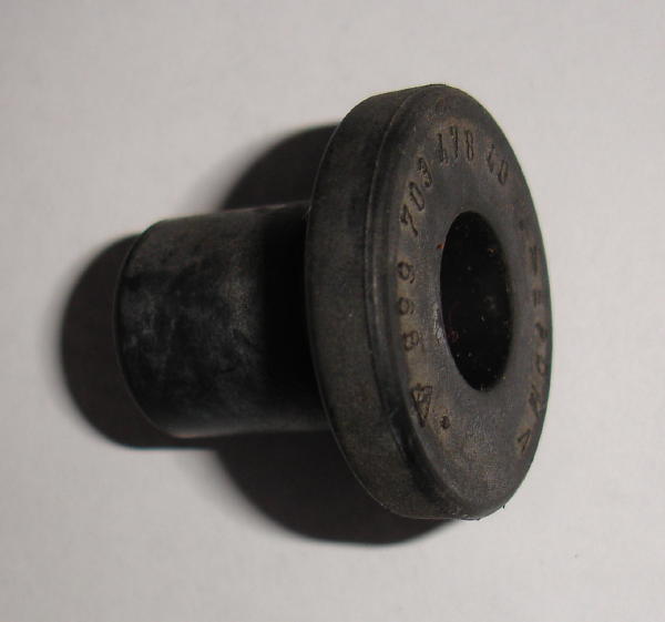

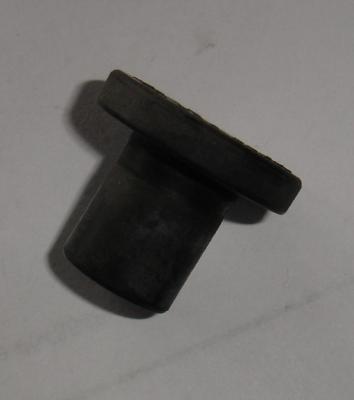

In any event, after I finished, I found this under my engine compartment. Anyone know what it is and/or where it goes?

Those go at the bottom of your air cleaner hosing to hold it in place.

Thanks Loren. One grommet was in the engine compartment, the other in the photo. Quite apparent that I needed these. Thanks again.
