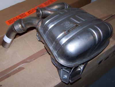

Is your car a Tiptronic? If so the mufflers need to have a flex joint, or corrugated section in them. Others have found if they put a straight connect muffler on a Tip then vibration comes into the car when in gear at idle. Goes away once under way.

It should look like this with the accordion on the incoming side.
got it. thanks. mine is a direct one to one replacement of the stock muffler. same straight pipes like on the stock muffler. same fitting etc. cargraphic has plenty of photos of the boxster sports muffler on their site. none seems to be offered with flex joints.
