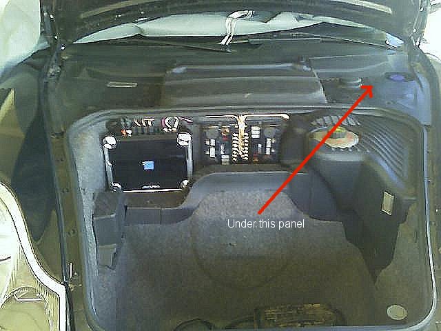

Not sure but mine went through the grommet on the drivers side on the firewall just behind where the wires are in the picture under the drivers side cover panel.

I used the body earth from the amp to gnd just behind my amp under panel on left side.
