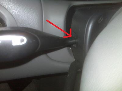

if you gentle wiggle (don't break it!) the turn signal stalk a little bit as you move it up or down and forward and backwards does make the turn signals come on? If it does you might want to try spraying some electrical contact cleaner where the turn signal lever/stalk attaches to the steering column. Sometimes gunk or dirt or stuff gets trapped in there and needs to be cleaned out.
