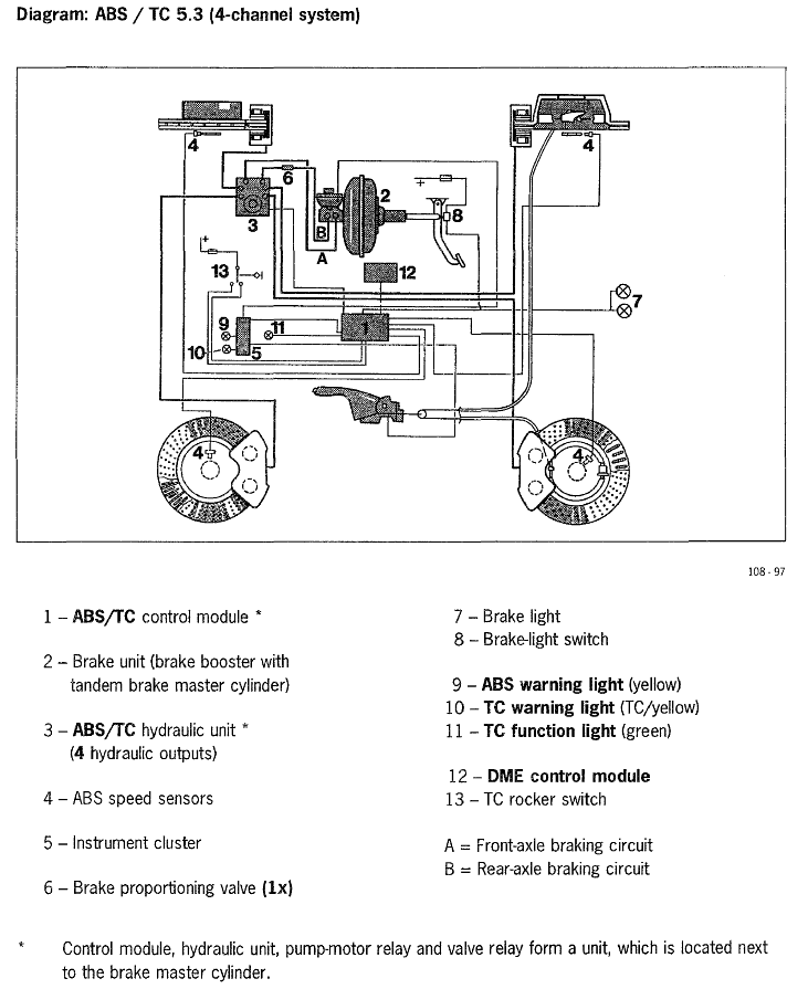

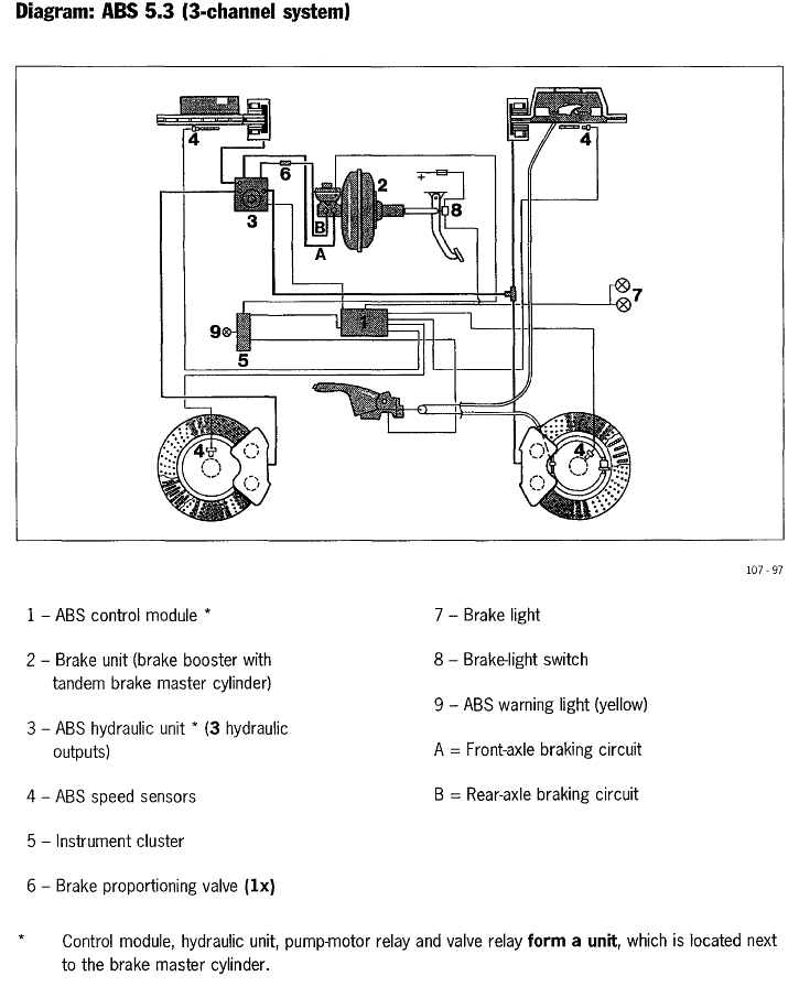

It's interesting that the hydraulics are different. I'm assuming I can modify the lines to combine the rear circuit.
What happens when the control unit gets disconnected from the DME? Anything more than a warning light?
I don't know - It does not seem like you have to do anything if you switch ABS control boxes.
Loren, thanks.
It is interesting the the DME is shown in the TC diagram but not in the other one.
I was talking to the librarian about purchasing a set of manuals. Would there be a description of that connection somewhere in there?
After thinking about it, this does seem pretty simple since I have the hardware.
Before I go there though, does the TC activate once the ABS kicks in like later PSM, or is it really turned off with the switch?
