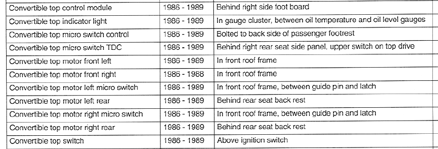

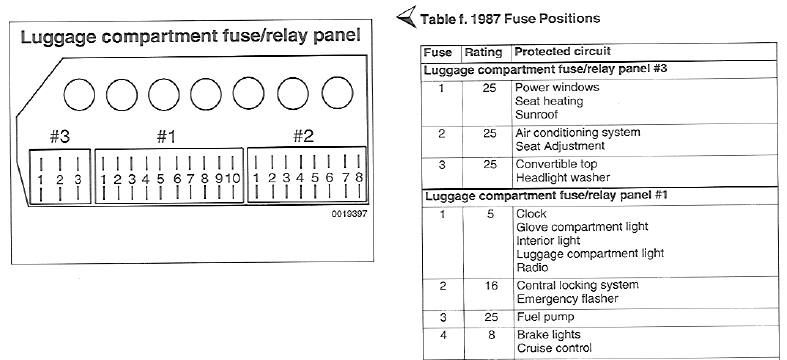

Paritally yes and thanks for your prompt reply. At least I know I can replace it if it is faulty. Where is the thing located in the car. I am trying check out the fuse and switches before I start replacing parts. Any advice?
