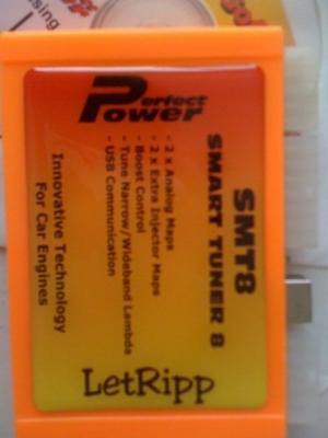

Thank You both for the input. I will start with the piggy back solution; It will be delivered today actually. It's the new model SMT8 and seems to be more capable than the old one. It does have PWM:
. I will get the engine to work with the SMT8 for now.

Here are the specs for smt8:
" The SMT8 piggy-back unit follows in the footsteps of the SMT6 and SMT7 units, but with unparallel performance and a quantum leap of technical innovation. This is all possible with the latest 16bit DSP processors, crammed full of features never seen before. This unit is for the professional tuner and engine builder.
One of the new features is the fully programmable engine protection which monitors the engines performance, and should anything exceed the specifications then it gradually reduces engine power after a programmable time delay. Absolute Magic!
Of course it has multiple analog modification channels, frequency and dual lambda modification. It can control boost PWM and has three bipolar ignition channels for one crank and two CAM signals. The two direct injector drives can be used as set point controls and can be mapped independently for fuel injection.
The mapping of all this is done via a high speed USB port and the user friendly LetRipp PC
· 2 Maps to influence analog signals
· 1 Map to influence up to three ignition signals
· 2 Extra injector maps to drive two injectors
· 1 Set point control with up to 3 outputs (relays)
· 1 Frequency modification map
· 1 AFR (Lambda) modification map wide/narrow
· 1 Boost control screen
· Calibration of all inputs: Engine Temperature, Air Temperature, AMP (MAP) Sensor, Throttle Position, RPM, Ignition cut, Ignition retard, ETC.
· Engine Protection via: Ignition software cut, Ignition retard, ETC control
I got the piggy back; just starting to study.

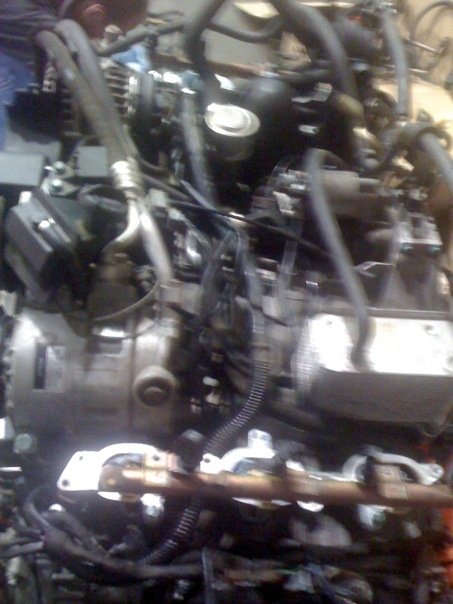

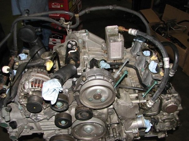

Striped down 3.6; switching things aound. :beer:
today: changes the injector rails to boxster - no return for the fuel tank - did keep the 996 injectors; compressor from the boxster(made in japan?!) - better shape; changed belt; harness from the boxster engine; connectors from the 996 harness for the variocam plus solenoids and the cam sensors.
Edited by sergiu

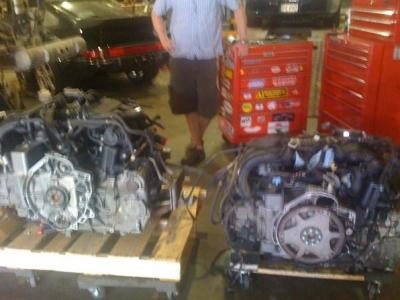

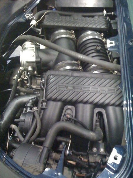

Quick update: the engine is in, droped 2 inch in the front, none in the back.
Injector rails from 3.6 back in. Fuel pump ordered.
Dme 7.8 going in on Monday. All the diagrams studied hard and this seems to be the best solution.
Boxster 2004 instrument cluster in the mail.
Still need the can hvac , but that can wait till winter
factory headers on for now.
The engine to start on Monday. Keep fingers crossed
