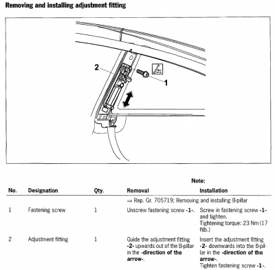

i'm putting my interior back together on my 2001 996 and i am having trouble reinstalling the seatbelt height adjuster. there is a little clip/spring that is supposed to cause the button on the height adjuster to rebound. something is not correct and the button is restricted. there is no detail in my shop manual. does anyone have a detail or can anyone explain how this should go?
