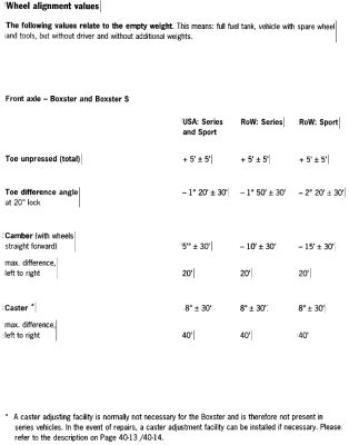

ROW M030 Alignement Specs
Good afternoon RennTech Community!
I recently had the ROW M030 Suspension Kit installed on my '98 Boxster and was wondering if anyone could point me to the proper alignment Specs for this kit?
Any insight would be much appreciated!

I myself am in need of an aligment. I have a question that I cannot find an answer for. Loren- thanks for posting the specs on those three different suspensions. I just bought a 2004 Boxster S 550 Spyder Special Edition. Info I can find says it's suspension is 10mm lower than a normal Boxster S. I'm "guessing" that makes it an ROW suspension? Or is it ROW sport? I'm not sure. Can anyone give me some input? Thanks, -Tom

The MY04 550 Spyder Special Edition did not get any special suspension - so it has the same suspensions the MY04 Boxster S. (The MY04 Order Guides can be downloaded on the Order Guides section).
If it is lower then it likely had someone change the suspension to the RoW Sport suspension.
Best way to find out for sure what is on the car is to get the color markings and the front and rear springs.
