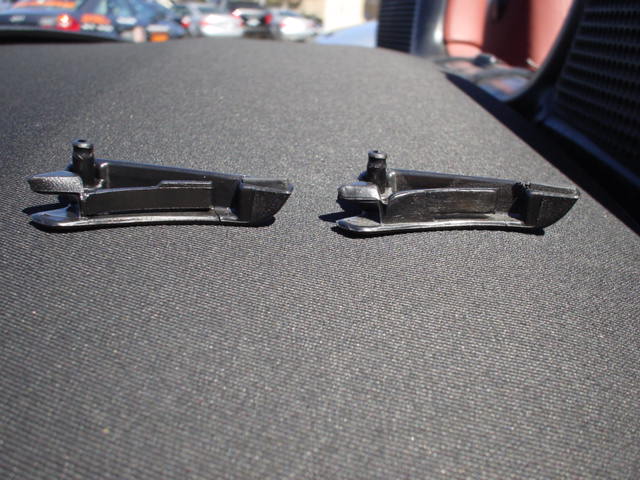

I needed to replace the passenger side clip on Dave's 1998 windstop which is on my 1997 Boxster. A bulletin was issued on May 25, 2004. The clips have been changed as of March production with a thinner plastic leaf spring, to reduce the chance of breaking. I replaced one or both sides on my original 1997 windstop for this reason. New part numbers. 986 561 737 01 01C and 986 561 738 01 01C. I wanted to take a picture of the difference, so the parts guy gave me all they had it stock to look

Went back to parts and they now had the new style.
The new style clip is on the left. Hard to see the difference, but it is different.

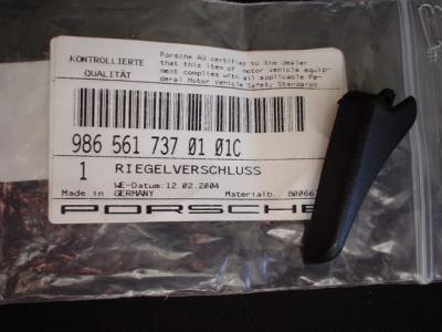

Be carefull when ordering the 986-561-738-01-01c and 737-01-01c both were marked L for LEFT side. I had to go back and show them and they brought out another bag same deal..two lefts. Maybe just a inventorymis labeling issue.

Similar issue here. The parts computer does not list left and right, it just shows 2 clips. I needed the right clip, which the bulletin says is 986 561 738 01 01C. But I bought 986 561 737 01 01C and in the sealed plastic bag was a right clip, which the bulletin says is for the left side.
