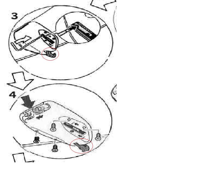

Thank you for the quick response and suggestions! Do you have any photos or instructions on how to disassemble the latch receiver?

Thank you so much! I finally had time to take a look at the latch and I noticed that the latch cover is what is pushing down the microswitch. The latch cover was loose so when the latch was fully engaged it never pushes the microswitch on all the way. All I had to do was snap the latch cover back in place and that fixed the issue! I have circled the latch in the photo below. There is a plastic cover that goes on top of the latch.
