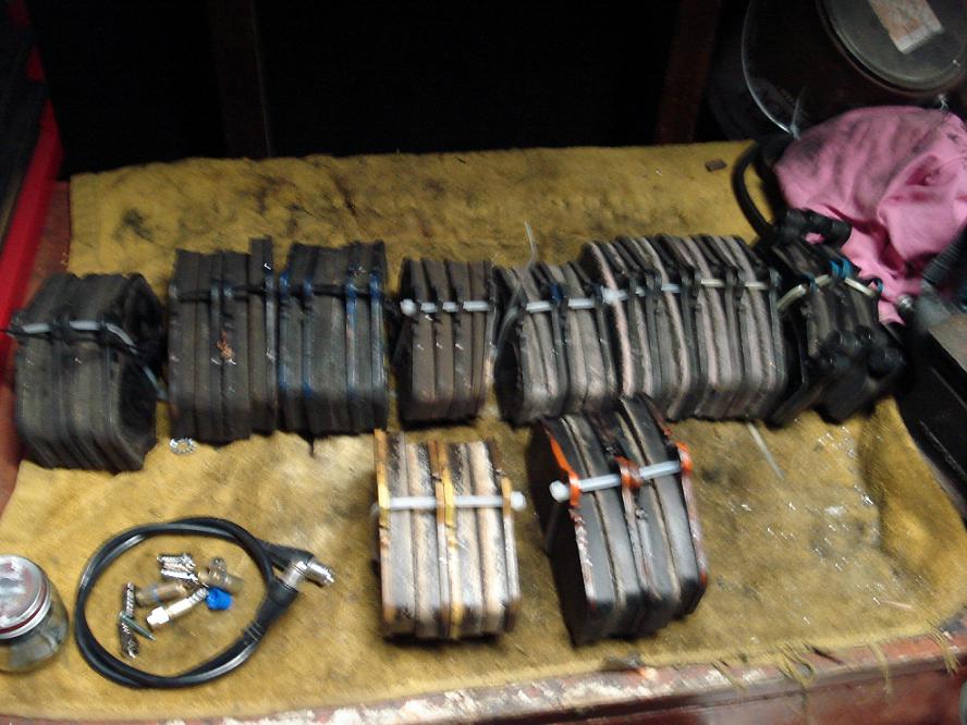

Not need but use it if you hafe it.
You do not remove the caliper. Just remove a pin that holds the pads, spread
the pads and put the new pads in.
Look for a brake post. It is a piece of cake replacing brakes.
The picture shows only Porsche brakes.
