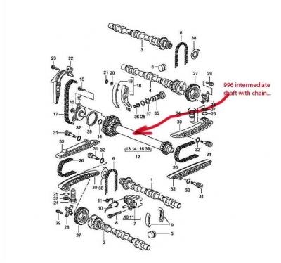

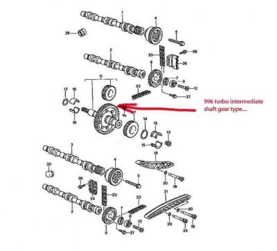

jpflip: Good post and reference to the video clip on the Intermediate Shaft.. That helps to put it issue in perspective..it's just too bad that Porsche hasn't seen fit to do something about these failures when video clips like this clearly show a common denominator on a weak part that's been prone to repeated failures. I hate to think of how much money has been spent by folks who have had to deal with this issue after the warranty ran out. When they go...they just let loose with what's been described as the sound of "a coffee can full of bolts".
Loren mention an important detail, there is a difference between the 996 and 996 turbo intermediate shaft.996 is chain driven and 996 turbo is gear driven. Completely different design...
More importantly it looks like the Turbo cam are both on the same side.
that seems like it would be less torque on the IMS as well as less mass.
All should help any bearing issues.
probably less play in the gears vs chain as well
